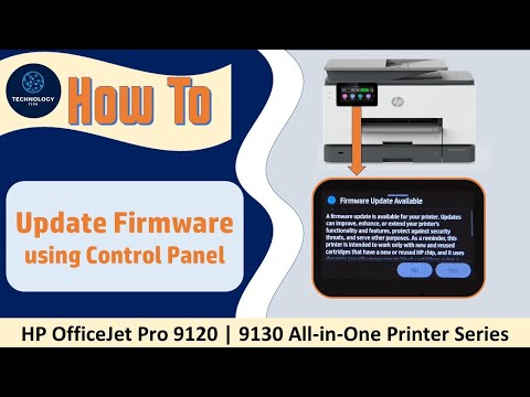

3. Update Firmware via Control Panel:
https://www.youtube.com/watch?v=NfFfdYFFj8U

Thank you so much @greenturtle . The videos were very helpful and it looks like the firmware download was successful this time.
