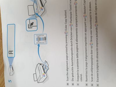

I was instelling and i thought i was done. The sound was annoying me so i turned the printer off. But the printer was NOT done installing and i forgot to scan the allignment page when i got code A. How Can i do a step back to code A? Help!

From HP Smart, open the Print Quality toolbox and print an Alignment Page, once the page prints be sure to put it on the glass and press on Color Copy to complete the Alignment process:
