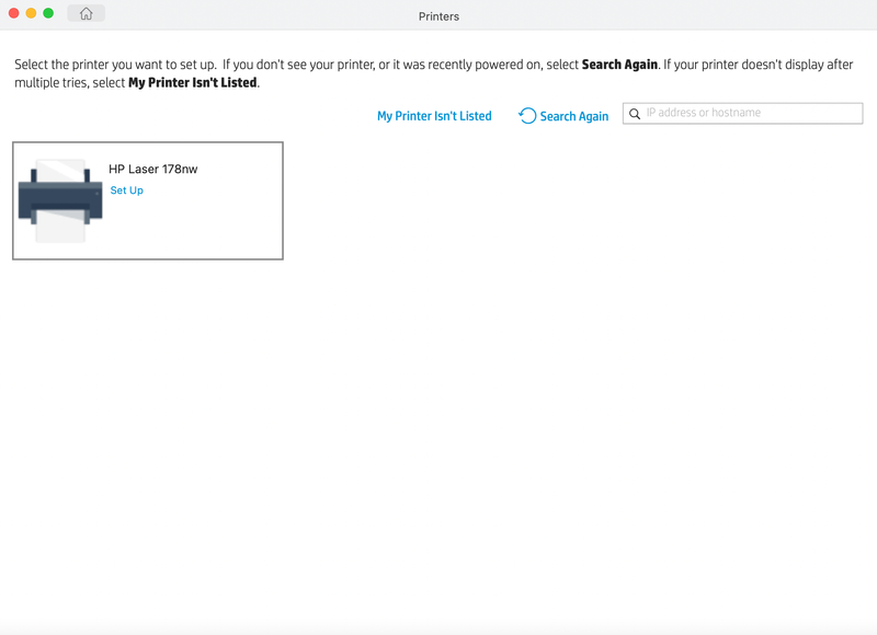

Hello,
Today my printer stopped working for Airprint and could not restore connection with my phone. Installed the HP smart application.
It detects the printer, connects to my WiFi but then the printer is not found when I have to manually add it to the list of printers.
I have also tried adding the printer by IP but it only detects it as a generic postscript printer and does not print.

Generally I would suggest restarting your router first, following its restart when the internet connection returns restart the printer and the Mac computer too and check if the Bonjour connection resumes, both AirPrint or the HP Smart app relies of Bonjour, and from your description I would suspect the router do not allow a proper multicasting communication which Bonjour services relies on.

No changes to the network and the  printer connects to my WiFi, including getting and IP address. Mac OS can find the printer but HP Smart does not manage to get the driver installed
A firmware update (and restart) of the AP worked.
Thank you very much!
