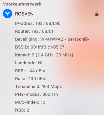

There is no anti-virus software installed. The wifi info:
I don't think it's a wifi issue, but the fact that I cannot pin the printer is strange. I can ping other computers (which can print) on the network.
