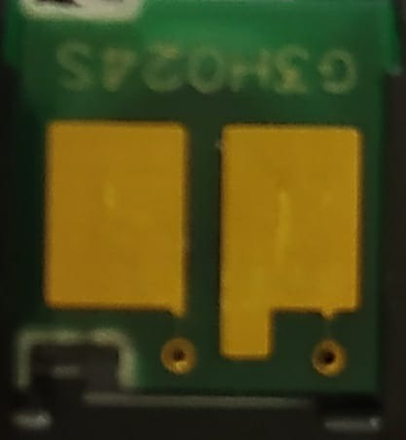

I entered the device HTTP web page to see if any errors were displayed and I noticed the error on the figure below (Figure 1). Guessing to https://support.hp.com/us-en/document/ish_1689737-1117532-16#:~:text=10.00.-,10%20Supply%20memory%20.... there is some problem with the toner catridge, it looks legit but the memory chip is kind of damage I think (Figure 2). Do you people think this is such a problem?
Figure 1:
Figure 2: Look closely to the small scratches:
