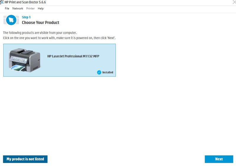

Interestingly, after a failed full service installer installation attempt, the HP Print and Scan Doctor recognises my device as being installed:
but when I select 'Next' I just get a "Failed to communicate" message with none of the suggested fixes working.

Ultimately the HP Print and Scan Doctor says "product is not connected" despite earlier recognising it as installed!:
