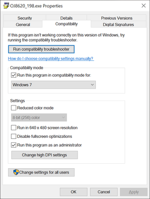

Uninstall what you may have left on the machine (for 8620 software/help & hpupdate-this version of update on my machine was from 2013 --& causing errors in the application log that threw me off track).  Anyhow,  then run the install package for the 8620... OJ8620_198.EXE in COMPATIBILITY MODE FOR WINDOWS 7.
For those that may not know how to do this, right mouse click on the install package, go to Properties, Compatability tab, put a check in the box next to Run this program in compatibility mode for:  then in the drop down box, select Windows 7 and hit apply/ok.
I also opted to check Run this program as an administrator, but honestly, it's not needed... I tried it with & without that box checked, so long as it's run in compability mode, everything installed fine for both wireless & wired ethernet connections.

OK... I just got it installed... SUCCESSFULLY!  And the solution is so stupid easy... I can't believe I didn't think of this myself... I kept digging through the posts on this forum until finally... I found what worked.
