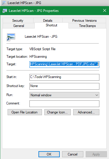

3.2  I named the other shortcut LaserJet HPScan - JPG  and I added a space then a 2 at the end of its Target property
I can now click on the shortcut I want and HPScan will open, scan and save without any further action on my part.
