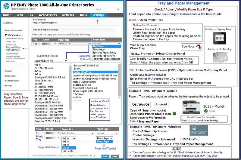

This printer has a photo tray.
The Photo Tray supports a limited number of sizes of photo paper.
EWS > HP Document / How-to
Use the HP printer Embedded Web Server (EWS)
EWS – Browser – Tray and Paper Management
Open your Browser > Type / enter the Printer IP address into URL / Address bar
Tab Settings > Preferences > Tray and Paper (Management)
Select / Adjust settings for Paper Size / Type
Model Dependent:  Advanced section
Click Apply to save changes
Tray and Paper – Paper Size / Paper Type / Paper Weight
Reminder
HP Smart Mobile requires that paper size / type is adjusted before the content is opened to be printed.
Paper Size, Type, and Weight loaded in the printer tray must be supported for use in that tray.
EWS provides access and control to check / adjust Tray and Paper Settings.
Note
Depending on the printer model, the Printer Control Panel might provide access to Paper Size / Type settings immediately after the paper is (re)loaded into the appropriate printer intake tray.
Custom size?
If EWS does not allow setting the paper size or size “Custom”, look for the setting to do so in the Printer Control Panel after (re)loading the paper to be used
What?
Paper Size, Type, and Weight must be appropriate for the tray in which that paper is to be used.
Depending on the printer model, Tray 1 might be used for Custom media.
In this scenario, Tray 2 might only support Plain paper.
OR
If the "Custom Paper Tray" is Tray 2, then Tray 1 might only support Plain paper.
Printers that include a Photo Tray generally place limitations on the size and type of paper that the Photo Tray supports.  Example:  Depending on the printer model, the Photo Tray might support only 4x6 inch photo paper.
Example - EWS - Tray and Paper
EWS_7855_Preferences_Tray_and_Paper_Management_All_3EWS_7855_Preferences_Tray_and_Paper_Management_All_3
