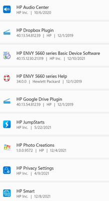

I did not succeed. Here are Snippits and the first one shows the HP software still in my Apps. First question: Can any of them be uninstalled?
