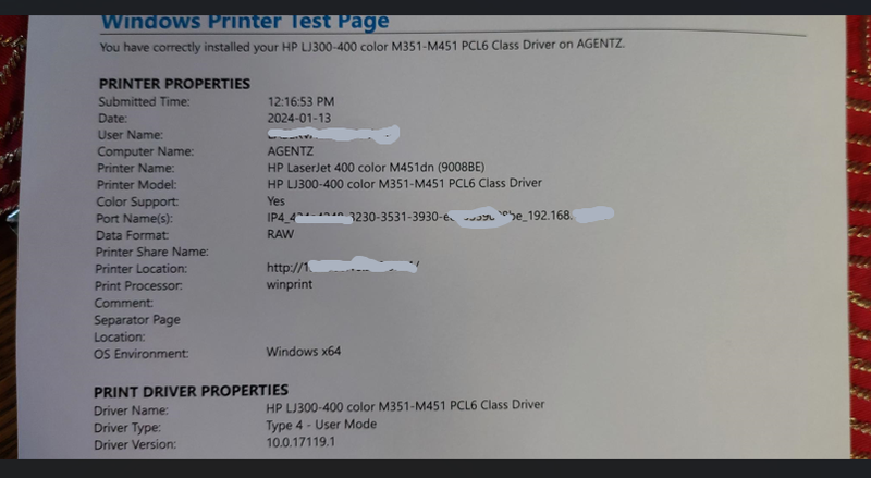

Thanks but this doesn't answer my question.  I'm looking for a driver that will allow my printer to work with Windows 11.
Pulled out my Win 11 laptop to check and confirm. I am printing to my wife's 451DN via TCP/IP port using the Microsoft class driver, which is a built in driver in Windows. Test page below.
