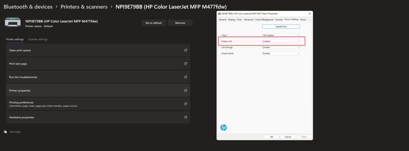

Hi,
To help other people who had same issue as I do, here is the option we need to enable. Thank you, it is working again.

Hi,
For printing, please make sure the Automatic Duplexing option is enabled:
Enter Control Panel > Devices and Printers.
Right click the printer icon, then click Printer Properties.
Click the Device Settings tab.
Set the Automatic Two-Sided Duplex Accessory as installed and click OK to save the change.
Now Automatic Duplexing should become available.

Hi ShlomiL,
Thank you for your reply but there has no Device Settings tab for me.
Gabriel.
Your screen shot appears that you selected properties and not printer properties. You need to select the option near the middle of the drop down menu.

Hi,
This is two different approached to solving the same issue. Either will net the same results.
