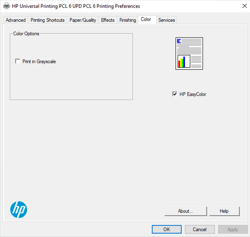

Here is the Color tab. You can see Easy Color was already checked and greyscale was not checked.
