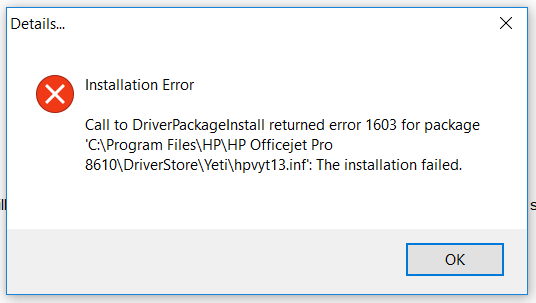

I had to do a reset on my PC due to a problem that occured with the Creators Update and now I can't get the HP software to install. I keep getting a 1603 error message pointing to something it's either trying to install or to see on the C drive, but there's nothing where it's looking. In fact, it looks like the software isn't even able to create the install directory.
Any help would be appreciated, but it looks like I'm not alone in having this problem.
Alright. I've uninstalled the software (again) and instead of reinstalling it I tried to install the Windows drivers. This worked and the printer is now available. That tells me it definitely does NOT like your older drivers. But that also means I can't install your software, which I actually like, and will need to use Windows Fax and Scan for scanning, which is quite a horrible app, OR I use the AIO app which I also don't like. Oh well.

Hi there. Appreciate you getting back with me. Unfortunately that didn't work either. I get the exact same error as it's finishing the first part of the install. Don't think it's a permissions issue though. I can see the directory getting created, but as soon as it fails it's removed.
Also, in an effort to get around whatever the issue is, I copied the installation directory from my laptop which had the software installed before the CU updated. I put it in the same spot on this machine and ran the installer hoping that it wouldn't complain about whatever that file is. That didn't work either. I'm stumped on this one. I just want to be able to manage my printer and scan things in an easy fashion!

I went through that document and tried what I hadn't before and same problem as before. So I downloaded the software you recommended and it had no problems seeing my printer, but said everything was fine except the software wasn't installed (DUH) so I downloaded it again thinking it might somehow be different. Same problem.
I even disabled UAC and tried to install.
Changed a few BIOS settings and tried to install.
No dice on all accounts. Honestly don't know what else there is to try. I've installed tons of other software and drivers after the reset and had zero issues.
I've been sending error reports over every time the install fails so maybe someone can find those and see what info is in there? I'm out of ideas.

Wow. Ok, so like I said initially, or at some point anyway, Windows had already installed the printer and when I went to look at it when all this crap started I installed whatever app it wanted (AIO Remote or something) and made me turn on Web services which I didn't want.
After trying to go through what you just sent I couldn't "add" the printer cause it thought it was already there so I removed it and tried to add it again. Well, that failed everytime saying that the drivers were "unavailable". Great.
So after the printer was removed from the system I figured why not try the normal install again and guess what? It worked! Or at least it somewhat worked. Now it doesn't seem to want install it as a network printer for some reason. It sees it in the list and it's fully online and I can get to it's web page so I don't know what this is now about.
Any ideas about that? And yes, at least I managed to get the software intalled so it's a step in the right direction.
