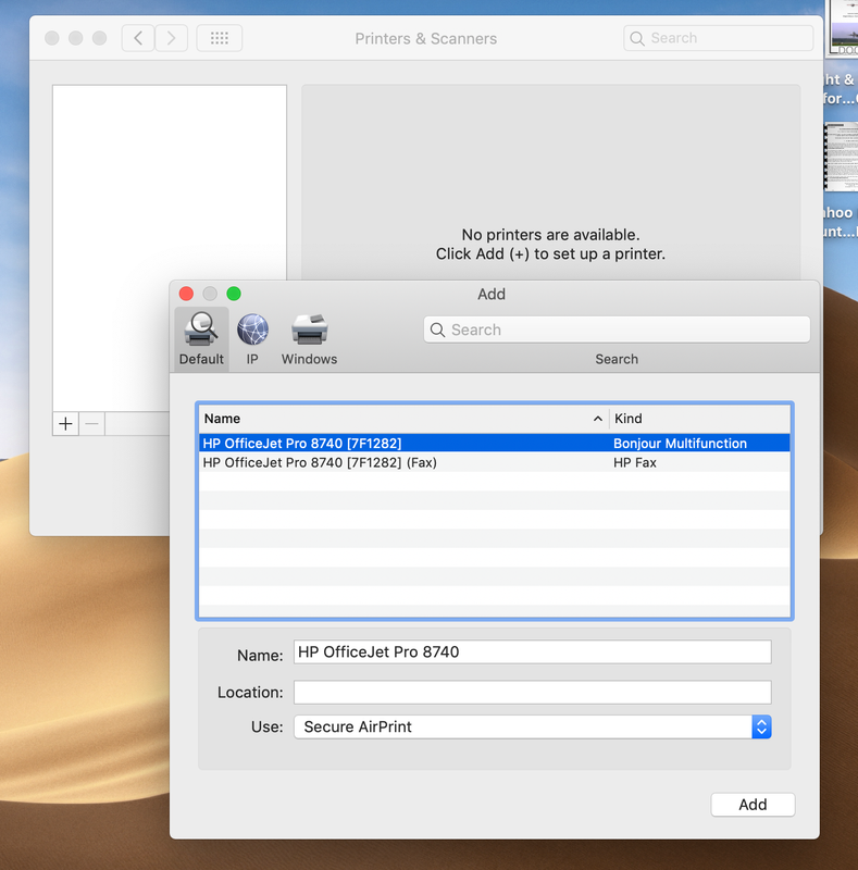

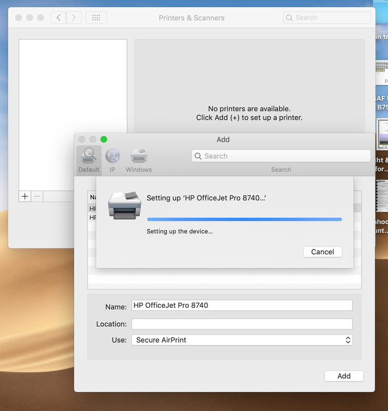

My Officejet PRO 8740 will not pair with my MACbook PRO. I have done everything in the trouble shooting guide. Updated the driver, turned off printer and wireless router, re-established printer with wireless, etc. etc. etc. Now the printer shows as available in the systems preferences printer area but when I try to add the printer it never completes the connection. I am getting weary with rebooting everything over and over again with no results.

Next remove and Re-add the printer using Airprint. AirPrint is an Apple technology that helps you create full-quality printed output without the need to download or install drivers.
1.) Click the Apple menu, click System Preferences, and then click Print & Scan or Printers & Scanners.
2.) Check if your printer name displays in the Printers list, If your printer is listed, click the printer name, click the minus sign to delete the printer.
3.) If you see multiple printer queues for the same printer, remove all extra printers by selecting them one at a time, and then clicking the minus button at the bottom of the list.
4.) Click the plus sign , click Add Printer or Scanner, click the printer name.
5.) Click the Use or Print Using menu, select AirPrint or Secure AirPrint in the pop-up menu. Then click Add.
6.) Try to print

I think the selection of "secure AirPrint" was causing the problem. The Auto Select feature was selecting this as a default. When I manually selected AirPrint everything began to work just fine. At least for now.
