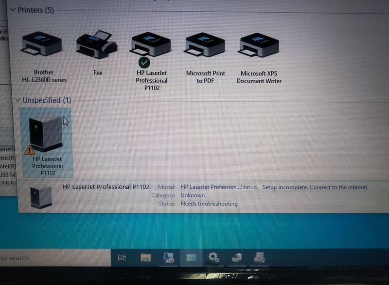

Hello there! I apologize in advance if this question is already asked, I tried googling for hours and asked the question in micrososft support but I still haven't gotten a solution to my problem
so my workplace PC network isnt connected to internet, and as you can see when I plug the printer to the PC, the windows doesnt recognize it as printer that I previously installed manually, but it read as another device that wants me to install it via windows update, when I tried to remove the original printer and reinstalled it, as you can see in the picture, the problem still persists
so far I already tried pause the windows update and disable it from service, then disable and uninstalled the USB device that appears whenever I plugged the printer that asks for windows update (yes the printer reads as USB with error message in picture 2 instead of printer) but whenever I replugged it, the USB device will appear it again even if I uninstall the driver ( i also tried to delete the driver file in system32 but still same)
I know connecting it to windows update will most likely solves everything and saves me the headaches but unfortunately the PC is offline so Im out of ideas to fix this,

It looks like the HP LaserJet P1102 is showing up as an unspecified USB device instead of a printer because the driver installation is incomplete, and Windows is trying to pull the driver from Windows Update, which isn't possible since the PC is offline.

  • In the second image, the USB Mass Storage Device is shown as disabled (Code 22).
  • Click “Enable Device” to allow Windows to recognize the connection properly.

Hello ! I apologize for the long response, I really appreciate the response though!
Unfortunately, your solutions dont work 😞
I tried reinstalling windows 10, then installed the driver with CD-ROM that I got when we bought the printer, and I also tried with driver from HP Support official webpage, but the result is same, as you can see in the picture 2, the installation progress stuck at there. the windows doesnt even recognize the connected USB cable, I also tried changing with other printer cables but still same result
In your second step of your suggested solution 'During installation, select “Use an existing port” and pick the correct USB port.' I didnt get that option during driver installation even with advanced setup whether its from CD-ROM and from HP Support website
Then in your third step of your suggested solution 'Select “Browse my computer for drivers” → Point to the folder where you saved the driver files.' this also dont work :(, the windows says the driver is already installed (as USB mass storage device) even when i browsed the installation from the driver folder
