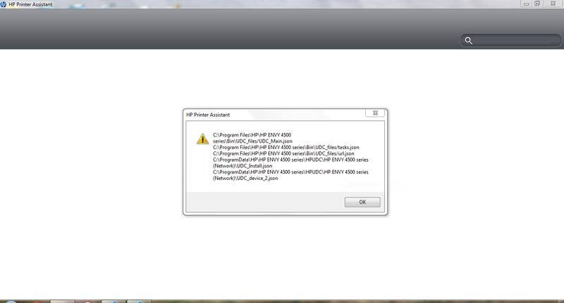

After an update from HP, the "printer assistant" no longer works. I get an error message:"string not found".
The printer works when I click print on any program I am useing but I can't go to Printer Assistant to scan from the computer.
I have already uninstalled and reinstalled with latest updates and used the Print & Scan Doctor. None of that fixed it.
Any other ideas?

Mr. Singh,
Did you get my reply yesterday which I sent as a direct reply from your email? In it I said not of the procedure worked.
I still have the same problem with the HP icon. I attached images of the error messages that happen when I click the printer assistant icon. I would send the images with this reply but don't see how to do it. Please look at your emails.

Below are the error messages I refered to. I don't understand what creating a new user account is going to do to fix the printer icon. This all started after an HP update.
