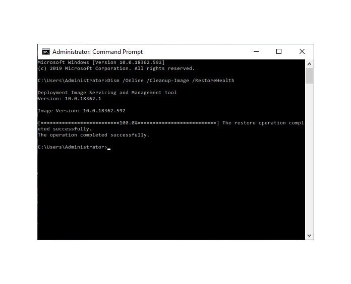

Hi Fanordi,
I have run the DISM command line with the following result:Will this have fixed Dism.jpgDism.jpg
Will this have fixed the TOTAL issue of Windows crashing, or just the administrator issue?
Do I still need to uninstall and reinstall the printer?
If your printer works on your computer I recommend to you just disable the super-administrator account! Do you have tested to print?

Hi Fanordi
Thanks for your help.  I have printed test page and a couple of docs from different apps, and so far all is OK.
Many thanks for your help and advice
Vic
It is a very good news because I will fear you need to reinstall Windows!
