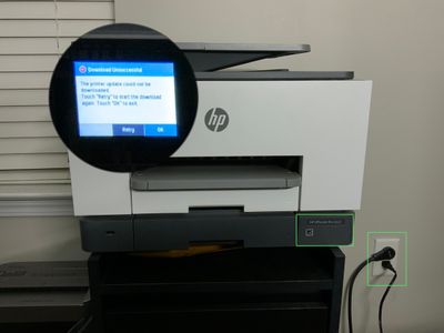

Meanwhile, I tried the steps that your provided in your response to Chuck, yet the issue persists. I keep getting an error message when my printer tries to download the latest software, "Download Unsuccessful: The printer update could not be downloaded. Touch "Retry" to start the download again. Touch "OK" to exit."
Once you click either of these options, the printer will try to auto-update again within 5 mins (constantly). This is quite frustrating because while its at the error message screen the printer is unavailable to print or do anything else.
Here are my printer details along with photo of the message on the printer:
  • Model: HP OfficeJet Pro 9025
  • Firmware Version: MANHHIPP1N002.2313A.00
  • Operating System: macOS Ventura 13.5
Also, the link to the Software/Drivers page for this model is not particularly helpful since it refers the user to the HP Smart app, which does not does resolve the update issue. And the macOS version of the HP Smart keeps crashing when trying to login to your HP account.
Please let us know what else can be done to resolve this issue since it's been ongoing for at least a week. Thanks for your help!

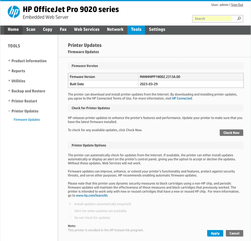

 To disable automatic updates from the EWS (Embedded Web Server) page of the printer, follow the instructions below:
  1. Open a browser and enter the IP address of the printer in the address bar.
Link for the document on how to find the IP address of the printer: https://support.hp.com/us-en/document/ish_6039801-6039767-16
  1. You might the below message

Thanks for the reply! This solution didn't work for me because the update settings are locked when I enable web services, which is a prerequisite for my printer to recognize the HP Instant Ink subscription.
I've restored my printer factory setting multiple times. The printer allows me to adjust the update setting until it requires me to agree to the terms and enable auto updates with web services. This process is not intuitive.
