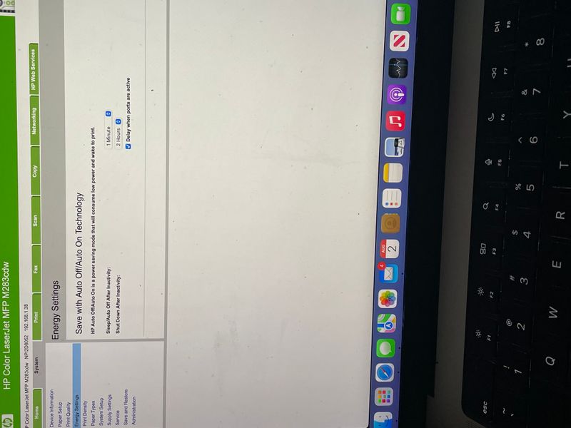

The settings for power are in the embedded web server of the printer. Type the IP address of the printer into a browser address window.  The embedded web server should look similar to this. You will likely be able to extend the amount of time until shutoff but may not be able to completely disable automatic sleep.

Thanks. The web interface will allow up to 8 hours until shut off. I guess this is an energy saving “improvement “, but I wish my interface looked like the one you showed as that one will allow standby all the time. Appreciate your answer. My old 8600 would be on standby all the time.

Here is what my interface looks like. I am going to adjust shutoff time to 8 hours and check the Delay when ports are active box. Hopefully as it will still be connected to Wi-Fi it will not shut down.
