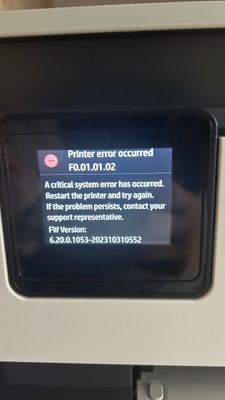

Thank you for the recommendations. I have tried all the recommended steps with no success. At the end I have tried to upgrade firmware and got an error F0.01.01.02. And later the device disappeared from the network.
