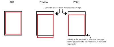

whenever I want to print a PDF in its actual size, the page content is pushed down, as you can see in the preview:
For the actual print on paper this means that at the bottom, part of the content is cut off.

It is not a driver problem - it is a hardware limitation.
This series of DeskJet printer models require a larger bottom margin.
Print Margin Bottom (A4)12.7 mm
Print Margin Left (A4)3 mm
Print Margin Right (A4)3 mm
Print Margin Top (A4)3 mm
I would guess the larger margin requirement is impinging on the document and causing the bottom edge to be cut off.

It still doesn't make sense to me:
Neither does the printer's behaviour make sense if there is more than one page:
This shows that the printer is able to print both the bottom and top margins that are required, but the content is shoved around and cut off (see 2nd page, there is enough space left at the bottom) for no apparent reason.

If you look carefully at the first image in the example, see that the document (text and image) does not fit entirely on the supported printing area for the paper (white background).   The content is extending down into the gray area on the preview sheet.
The printer needs a larger margin along the bottom of the printed page.
The "actual size" of the content does not fit inside the supported print area.
If the data does not fit on the paper where the printer is allowed to print, the content will be chopped off.  Apparently, that "does not fit" result might also mean that subsequent pages are shoved out of alignment.
Does the page print if you select "Fit", "Shrink oversized pages", or enter a Custom Scale (try 97%, for example)?
If yes, (it is my opinion) that is your option for this printer.
The other printers you have used to test the job likely do not have this weird "larger bottom edge" limitation present in less expensive HP DeskJet models.

Hi and thank you, again! I really appreciate that you are trying to help.
Yes, I would agree with you IF the printer (or the software since it's already visible in the preview) didn't increase the top margin for no apparent reason. That increased top margin pushes the content down which is the reason the bottom is cut off. If it wasn't for the increased top margin, the content wouldn't extend into the gray area.
I know the margins are no problem for the printer technically, neither bottom nor top.
Maybe I just don't understand what you are trying to say, I'm sorry if that is the case 😉
Shrinking oversized pages works, yes, but I needed to print this particular document in its original size and that's when I noticed the problem.
