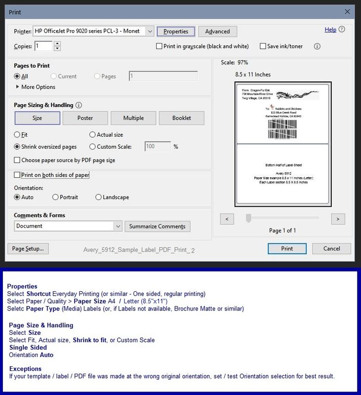

Examples - PDF Label Printing
Avery_5912_Sample_Label_PDF_Print_2Avery_5912_Sample_Label_PDF_Print_2Avery_L7160_Sample_Label_PDF_1Avery_L7160_Sample_Label_PDF_1

This is essentially correct - PDF printing is not ideal when you need to adjust the margins - PDF documents generally inherit their boundaries from their "pre" PDF document format (original Word template document, for example).
Check the margins / sizing of the PDF file
Open the PDF file in Adobe Reader DC  > Set the scale to 100% / Actual size
Check the margins / sizing in Word
Open the Word document > Layout > Margins > Click on the drop-down menu
Click at the bottom "Custom margins..."
