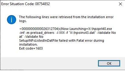

Looking at MS forums the suggestions was to reinstall the device driver.  So I went to Settings -> Apps and uninstalled “HP Photosmart C4700 All-in-One Driver Software 14.0 Rel. 6” and did a reboot.  I tried using the CD that came with the printer but the only option I got was “Exit.”  So I went to the HP website and downloaded PS_AIO_06_C4700_140_408-5.exe and ran it.  I did get the “Install” option and used it.  It got to the “Hardware Setup Guide” window when it fails.  First came up the dialog box: “”C:\Users\vjs\AppData\Local\Temp\7zS393E\Setup\hpzpr\40.exe” –inf…  Fatal error during installation”.  When I clicked “OK” and then clicked on “Details…”  I got “The following lines retrieved from installation error” and this window:
I tried using the “HP Installation Error – Windows 8.hta” that got downloaded but it didn’t do anything.  Any help with this would be appreciated.  This major Windows 1903 update will eventually have to be installed on my other PCs because MS eventually forces you to install their update.  Thank You.

Thanks for your reply.  I followed your steps to try to reinstall the software but it failed again with the same error.  I then followed the procedure to install using Windows Built-in print Drivers. which worked but only for basic printing.  The driver name is "HP Photosmart C4700 series."  When I tried to use the "Print on both sides" option the print queue would get "confused."  Sometimes it would work and sometimes it wouldn't finish printing and an entry would always remain in the print queue.  I can't cancel it no matter how many times I try.  I have to delete and recreate the queue to get rid of it.  I also found out the Scan app can't see the printer when before it did so I also can't documents.

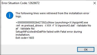

I tried using the 2nd option and it said:
Driver HP Photosmart 4700 series was removed.
Package hpc4700.inf was removed.
I rebooted the PC before trying to do the full install and the install still failed at the same place but with a different "Error Situation Code: as follows:
