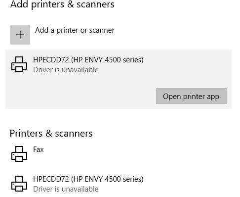

This is the screenshot I get using HP Smart - 'Driver is unavailable'.  😞
Hi,
Please follow the steps below to resolve such an error:
**Be aware that if you have other printers installed on your PC, those will need to be reinstalled too once completing these steps.
1. Uninstall the HP Software from your PC.
2. Backup your registry prior making any registry changes:
     https://support.hp.com/in-en/document/c03485724
3. Update your registry using the Reg file below (that will change some printer related policies for your PC):
     https://www.dropbox.com/s/avbv56zdgwv7600/kernel.reg?dl=1
4. Right click the Start menu and select Run.
     Type Services.msc and press OK.
     Locate and stop the Print Spooler service
5. Browse to c:\Windows\System32\spool\drivers.
     Rename W32X86 to W32x86.old
     Rename x64 to x64.old
     Note: if any of these folders fail to delete reboot your PC and then Continue following the steps starting from Step 4...
6. Restart your computer.
7. Reinstall the HP Software and check for any difference
Please let me know the results,
Shlomi
Click the Yes button to reply that the response was helpful or to say thanks.
If my post resolve your problem please mark it as an Accepted Solution 🙂
Thanks ShlomiL, I'll try this in a few days when I get back. 👍🏼
Thanks ShlomiL - all sorted! 👍🏼👍🏼
