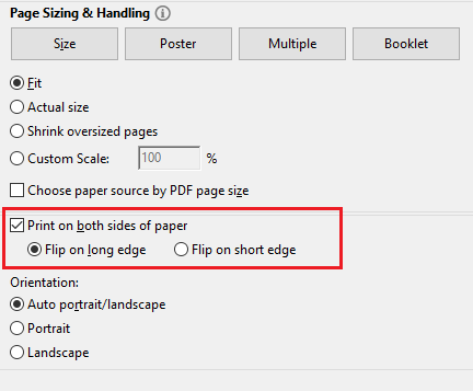

The printer uses the Duplex mode in Adobe Acrobat Reader, and I cannot find how to switch this of. I have searched in the printermenu and the Acrobat menu.

@alide
Fpr all PDF files or just one file ? For normal PDF files, you should be able to see
Regards.
BH

Thank you very much, this is the solution!
