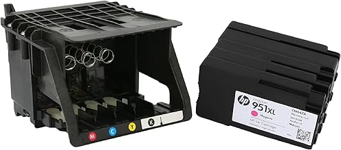

Hi and many thanks for your suggestion.
I am not able to do any operation from the printer panel.
It is no fun being w/o the use of the print, scan or fax functions !
I have placed an order from Amazon
 https://www.amazon.com/dp/B079NTTVMK/?coliid=IFBBBKH9TS8W5&colid=2TIROB2HTNYNX&psc=1&ref_=list_c_wl_...
and expect delivery tomorrow at a lower cost than ordering from the HP Store.
BTW, is it recommended to keep the HP8600 powered on to avoid drying out inkjets?
Also, is an automatic printhead cleaning done if the printer is powered on, or must it be given a command for a printhead cleaning to be done?
