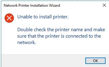

Has anyone had a problem using HP UPD 6.6.5 PCL6/PS drivers in Windows Server 2016 printserver?
My problem is that I cant install new printers if I use 6.6.5 drivers.
ERROR CODES:
Failed to add printer , error code 0x57. See the event user data for context information.
Opening printer \\PRINTSRV\printer,LocalsplOnly failed, error code 0x709. See the event user data for context information.
(just to clarify, we dont use dns cname on that server)
Everything works if I use 6.6.0 drivers.
The 6.6.5 driver works when I use 6.6.0 driver to install the printer and change to 6.6.5 later, but Device Settings Tab in driver manager hangs and Automtic Configuration is not working.
