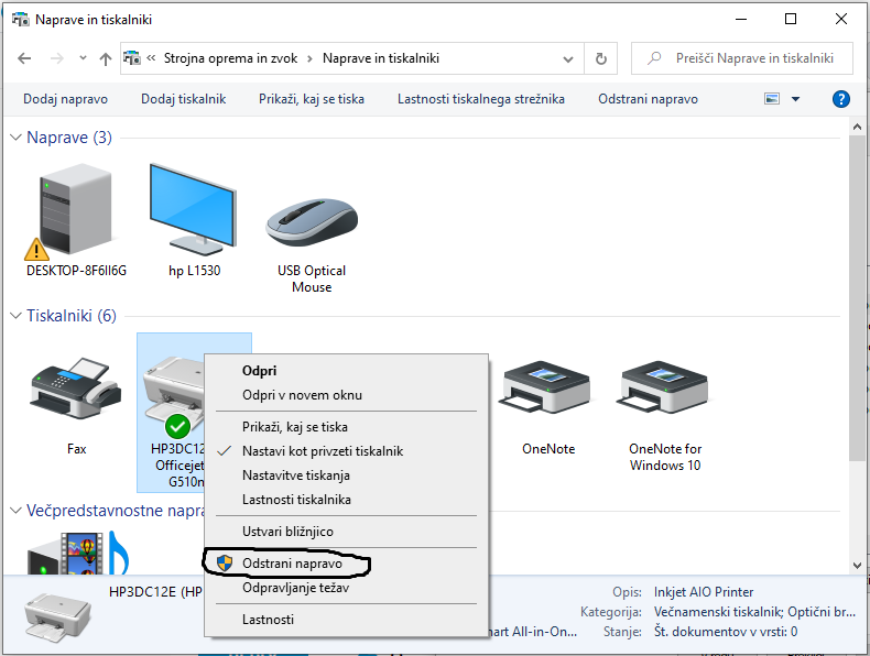

Hi again,
First 3 steps - I don't see any HP printer listed in order to uninstall it.
In the rest of the steps I have been able to remove the device:
and the driver:
Note that the HP OJ class driver (WSD type) has been removed and not the native driver.
