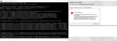

, i have sawn that you solved the error 5 for the hp product ( yesterday i have done the windows 10 pro update and now those two hp products dosent work on lan connection) ,i have the same problem with my Officejet Pro 8600 and my Desingjet T520 i really will love you if you can help me with this problem becuse i saw that if the hp product  is different you need a diffirent command on the cmd to solve the problem becuse if i try with those codes (even running with administrator) my cmd told me for 4 process the command works fine but the last process tells me access denied (italian word for access denided is accesso negato as the cmd shows) .

Hi @Mangageom,
From reviewing Microsoft documentation for the Takeown command for Italian, it seems to me as the same prefix should be used for Italian too as much as I can understand, although I cannot be sure due to not being familiar with the Italian language.
Please review Microsoft's documentation below and see if any value may be used differently for the Italian locale when using the Takeown command:
https://docs.microsoft.com/it-it/windows-server/administration/windows-commands/takeown
May you see any difference when using a capital Y with the command as below command? it might be more crucial for the locale, but this is basically just a guess.
Spoiler
takeown /f %windir%\System32\DriverStore\FileRepository /r /d Y
icacls "%windir%\System32\DriverStore\FileRepository" /grant %username%:(OI)(CI)F /T
takeown /f %windir%\System32\DriverStore\FileRepository /A /r /d Y
