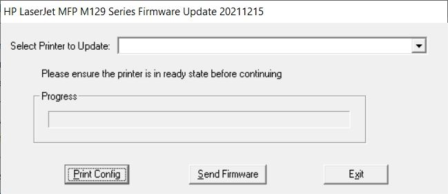

Hello!
I have to add that I could restore the USB connection to the printer and start the update procedure.
The only firmware version I found on the HP website is:
HP_LaserJet_Pro_MFP_M130_M132_Ultra_MFP_M134_Printer_20211215.exe
When I start the update the data is correctly loading to the printer. The second step is to clean the Eprom. After a few seconds the update aborts with the message Fatal Error 7.
I am quite sure that the update file is corrupted, so I am looking for a previous version. Can anybody help?
By the way. When I start the update the Window is naming 129 Series but the printer is a mfp m130nw, refer to the screenshot.
Max
