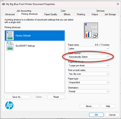

What format are the documents, if they are PDF, then you need to set Acrobat to print based on PDF size
Then you need to ensure that you tell the driver to select paper source automatically.
You also need to ensure that you have the paper sizes and types set properly on the printer itself. So one has to be set letter the other legal. You cannot use a paper size of any as this will stop it from working.
