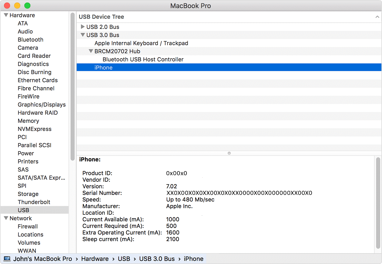

Do you have any Antivirus installed on your Mac?
Is the printer connected directly to the Mac or through a Hub?
Could you check and let me know if the printer is detected on the USB device tree?
1.) From the Apple menu, choose About This Mac.
2.) Click System Report.
3.) Under the Hardware heading on the left side of the System Information window, click USB.
USB 3 devices appear under USB 3.0 Bus, and USB 2 devices appear under USB 2.0 Bus. The printer should be under the USB 2.0 Bus, click the device names to learn more about each one.
Keep me posted 😊

Hi KrazyToad,
thank you for the response and it helped 🙂
The printer was connected to the mac with the usb Multiport adapter because the new macs don't have the usb ports like the old ones.
I opened the USB device tree as you suggested and it wasn't showing the printer, so i tried connecting it to all the 4 ports one by one..Turns out that out of the 4 ports in the new mac devices i can connect the printer only to 1 (and that too on the right side of the mac) if not it doesn't detect the printer at all.
Solved the problem atleast!
