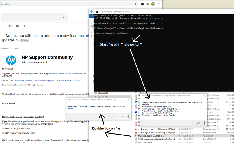

Hi,
The Microsoft uninstall fixer MSIPatchRegFix-AMD64.exe isn't helping; "Product code not given in argument". I gather that the partial uninstall has removed the bit it needs to find the right uninstall.
I notice when I do the uninstall from the Program&Apps controlpage, that it then asks for admin rights to 4a9ea0.msi. There is no such file on my computer, but just before that there is a short "unpacking" message, so … does the HP uninstaller generate temporary msi files? Now I could try and catch a copy in midflight so to speak, or you can tell me a product code? I run the MSIfixer in a CMD window with admin rights and tried the "-?" switch and got the message with an example product code "{CB2F7EDD-9D1F-43C1-90FC-4F52EAE1172A1}". I am not going to try that or any other random key.
And does this tie in with the message I get that while the normal uninstall runs that hpwia_dj2540.inf it needs admin rights (which I really can't see it hasn't been given as there is only me on this laptop and I am admin)?
The link you give is drivers for HP 5820, I have a 2540, so it will support that?
Thanks for not giving up on me yet 🙂
I have edited the post with the right drivers.
The troubleshooter should not be asking for a product key, could you share a screenshot that screen?
let me know!
One screenshot showing both starts I've tried.
