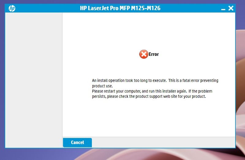

I have HP LaserJet  Pro MPF M125a (On Windows 10, 64-bit, OS). I've been trying to install the printer for a couple of days now.  The installation process is stuck at 99% and it shows the same fatal error (it takes too long to install). I've tried over 10 times, different methods.

1. I've already tried with the  https://ftp.hp.com/pub/softlib/software13/printers/LES/M125/LJPro_MFP_M125-126_full_solution_15311.e... many times. (And I tried once again, as you suggested. I should mention also, that I removed all HP devices and did a clean boot, again, before the installation, just in case.)
2. It reports the same fatal error, after 20 minutes of the installation process.

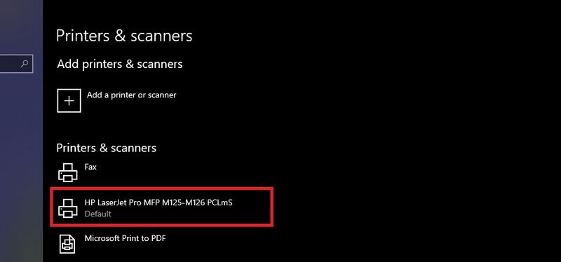

4. The only thing that works is adding a printer through PRINTERS AND SCANNERS (win10) and using an inf. file from the unpacked/unzipped installation package (step 1).
I've been using the following:
Printers and Scanners > The Printer that I want is not listed > Add a local printer with manual settings > Have Disk

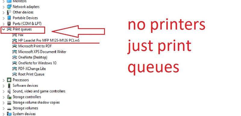

5. It's puzzling (for me, at least) that the Device manager doesn't show in that way Printers but ONLY printer queues.
