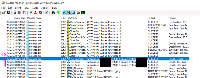

I have analysed it with procman.exe. The trace shows that the UPD driver on the client is
connectings "e87640.printers.mynet.de" on port 3910.
This blocks for 20 seconds, after 20 second procman "continues" with logging.
The trace for the cm6030 does not show this TCP connect.

It's port 3910, screenshot of procmon:

I have now installed a host in the printer network, which prints over the printserver, thus the printer is accessible from the subnet. The result ist:
- TCP lookup still happens
- it only takes ~ 1 sec
