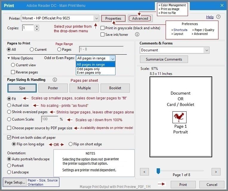

The following assumes (requires) that the Full Feature Software / full driver printer software is installed.
Example - HP Smart Windows - Simple PDF Print
HP_Smart_W10_PDF_Print_5
More examples...
Open the PDF file in Adobe Reader DC
Click the Print icon
Set up the main menu options
Open Properties
Select Paper Size
Select Shortcut for Everyday printing (or Duplex as available)
Select Paper Type = Brochure / Presentation / Thick / Card (as available)
Click OK to save the change and exit Properties
Back on the main print menu, click Print
Example - Adobe Reader DC - 1/2 Fold Card - Booklet
Booklet_Print_9025_PDF_2
Example - Adobe Reader DC - Duplex
Manage Print Output with Print Preview_PDF_1H
