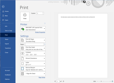

Please open any application such as Word, click on file > Print and then expend the printers list so any available printer is visible.
Could you please take a screenshot of this list and attach it in your reply to get some better understanding?
Shlomi

MS Word only lists the one default printer, the only actual printer in our home network.
I also include the lit of devices listed in Settings.  Again only that same printer.
I do not know what happened of the two screenshots I had uploaded. I may have failed to send them after uploading them. I'll try again.
