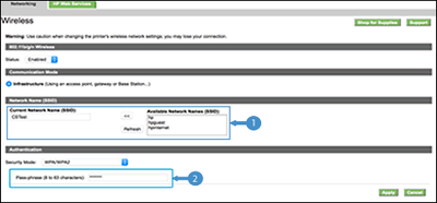

You have missed the option there, the Security settings are right below when you select the WiFi SSID within the HTML Config Utility
From there double-click your network name to add it to the Current Network Name field, select the Security Authentication type of your router and enter the network pass-phrase (Figure 2), and then click Apply.

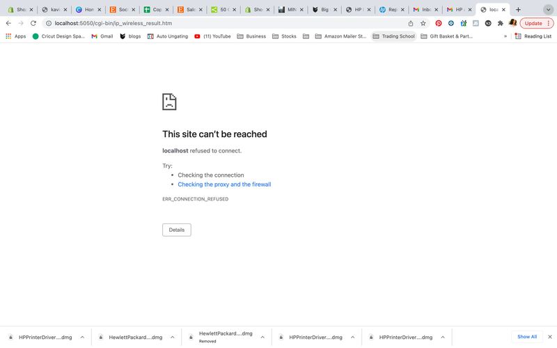

I am having the same problem. However I accidentally deleted the IPv4 , IP subnet and IP Default Gateway from my printer.
When I add my network and passphrase it gives me this.7BA71796-9336-4D8A-969F-7732329D64AC.jpeg

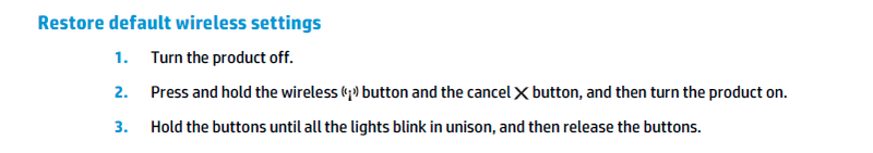

Next. restore the Wireless Defaults of the printer as following:
Now plug back the USB cable and access the HTML Config Utility once again, then check for any difference.
