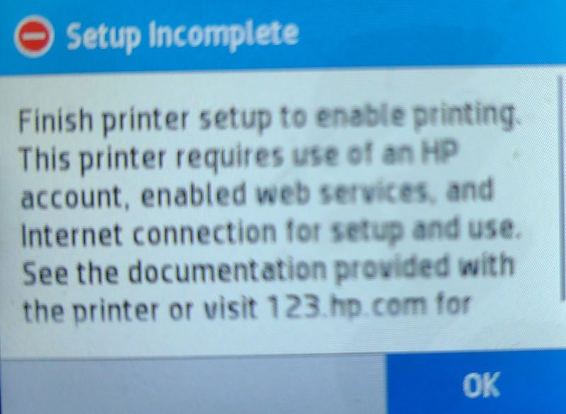

For the SSID that I'm using, the router is set to 2.4 GHz. The status of the blue wireless light on the printer is steady. It's connected to a private home network. I tried to print the wireless summary using the touchscreen, but it gave me this error saying setup incomplete. I don't know why because the HP Smart App is already installed on my computer.
setup incomplete errorsetup incomplete error
