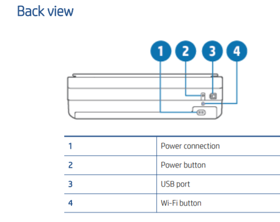

On the back of the printer, press and hold the Wireless button for 5 seconds. This will put the printer is in the Auto Wireless Connect (AWC) setup mode.
When the printer is in the AWC setup mode, the Edge lighting will glow purple, pulsing from the middle outward, repeating.
