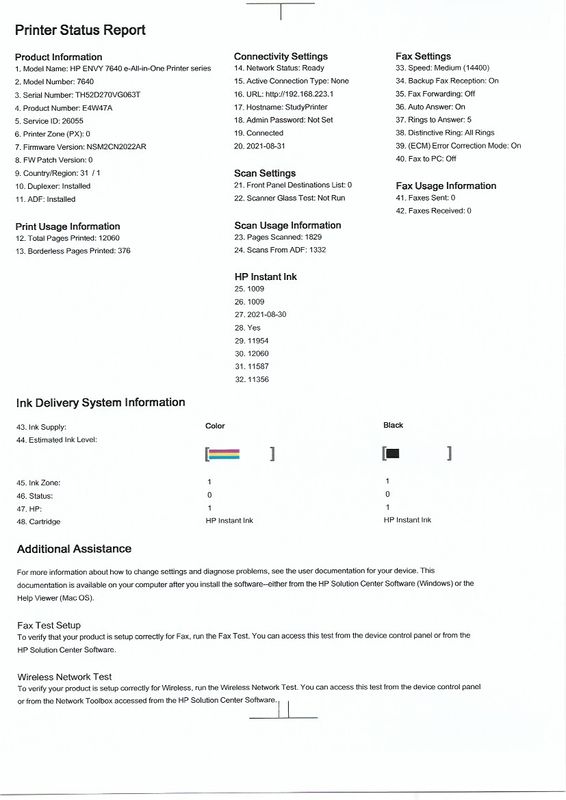

09-01-2021 06:48 AM
Thank you for sharing the configuration report.
We could try a semi-full reset on the printer, but this erases everything on the printer and we would have to re-enroll to instant ink with a different claim code.
Please let me know if you are willing to try.
Or please reach the HP Instant Ink team(contact info can be found on the home page) in your region for further assistance.
Hope this helps!
