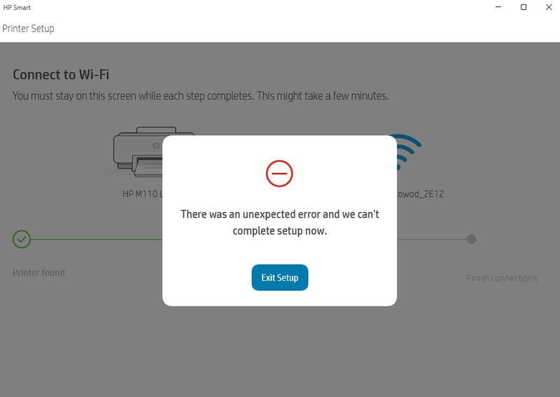

By following installation guide I'm getting the following errors. How to fix it?
- printer is placed close to router and laptop
- printer is new
- using iOS app installation fails as well
- after reset of a printer setup the result is the same
- router reboot did not help
5 REPLIES 5
In the result I can see the Wi-Fi network of the printer, but the Wi-Fi indicator is blinking on the printer control panel. And printer could not be found by the HP Smart app.
That message shows up when attempting to print directly to the printer.  I suspect it is asking for the WPS pin which is usually 12345678.  I am just guessing for the PIN.  You need to get a network report to find the pin
Please try to connect to the router.  if your laptop or smartphone runs at 5ghz it will never connect to the printer directly.  Has to go through the modem/router.
