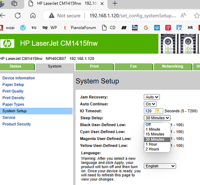

A quick fix is to set the sleep to off or never. Access the printers embedded web page and set sleep to off or never.

First get a network report from the printer so you know its IP address or Mac address
Log into the modem and look for the DHCP server. Find the IP or Mac address of the printer and make it a fixed IP address.
