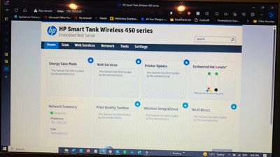

After re-connection to my router I proceeded to the printer IP again through my browser… Below are several screen shots of what I actually see my end.
I proceeded to to the section you mentioned to find the Security Tab …”Click the Security tab, and under General Security,” … this direction is not correct… There is no General Security link in this section., only the two link to

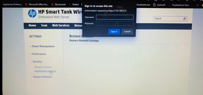

So in seeing what was presented my end I assume you may have been referring to click on the
Administrator Settings. ?
As you can see once I click that link the “Sign in to access this site “ window pops up telling me “Authorization required by https://192.168.0.22
I actually entered http://192.168.0.22 but continue to be forced to view the page under https://
So I selected Do not show me this message again and clicked Cancel …
I was then presented with another screen saying that I must view the page securely and “Redirect to HTTPS”
So I have to accept it and get the same Login window wanting the user & pw credentials to view the page ….
