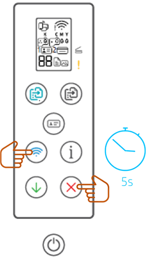

Press and hold the Wireless button and the Cancel button for five seconds until the Wi-Fi light blinks blue.
Pressing the Wireless and Cancel buttons for 5 seconds
Within two hours, return to the app or software to find and add your printer and complete the setup.
