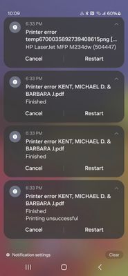

One issue I was trying to deal with is the print spooler continues to show print jobs that have completed weeks ago.  There was an error initially, but then all the jobs finally printed successfully.  I get these notifications on my android phone every time I unplug and re-plug.
I read about how to go about clearing the spooler and that process did not work. See screenshot.
