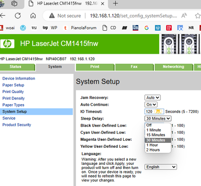

In either of the above two cases, I am guessing that the IP address of the printer has changed.  Alternatly, the printer went to sleep and the router cannot wake it up and turning if off and back on fixes the sleep problem.
See if you can disable sleep on the printer.

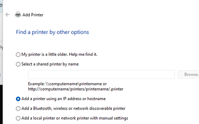

In windows 11 use the "add a printer manually" and select the TCP/IP not IPP after clicking next.
Alternately, bring up printers and scanners, find your printer, and edit the existing IP4 address to use the hostname of the printer.
