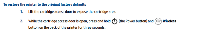

If you fail to complete the task, I would also suggest restoring the factory defaults for the printer and then try again to reconnect the printer using the HP Smart app:
Restoring the factory defaults is described in page 109 of its manual:
http://h10032.www1.hp.com/ctg/Manual/c06584211.pdf
