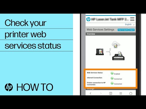

Learn how to check your printer web service status. Follow the steps in this video to easily check your printer's Web Services status. Chapters: 00:00 Introduction 00:16 HP Smart app to view web service status 01:30 View web service status in web browser For other helpful videos go to ...
